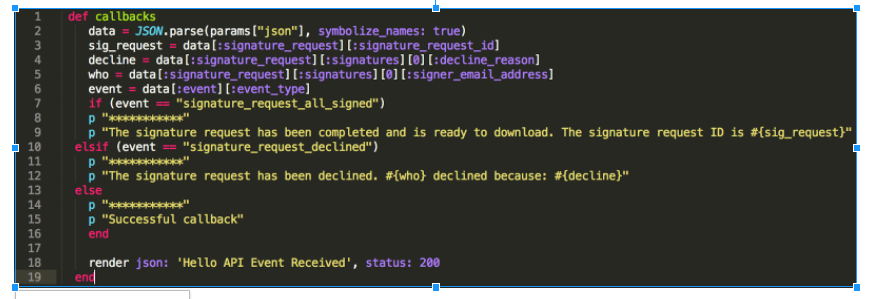

Step one:
Create a method that can accept a webhook from Dropbox Sign and return a 200 HTTP code and a response body containing the following text: Hello API Event Received. The example below grabs the signature ID and prints it out to the console for various signer events. The code snippet will need to be edited to use in your integration.
Ruby callback handler
