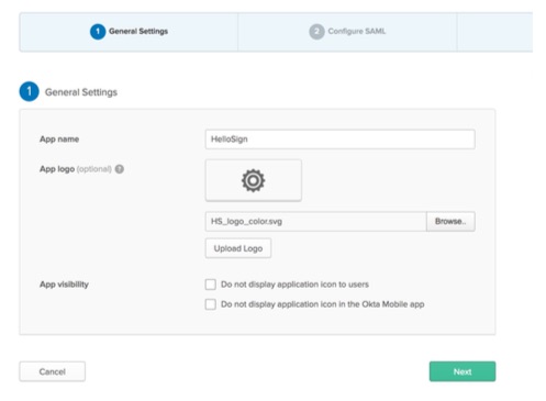

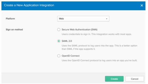

IDP setup flows and default values vary. See the following steps for an example using Okta:
  1. Create a new SAML 2.0 web application and name it “Dropbox Sign”.

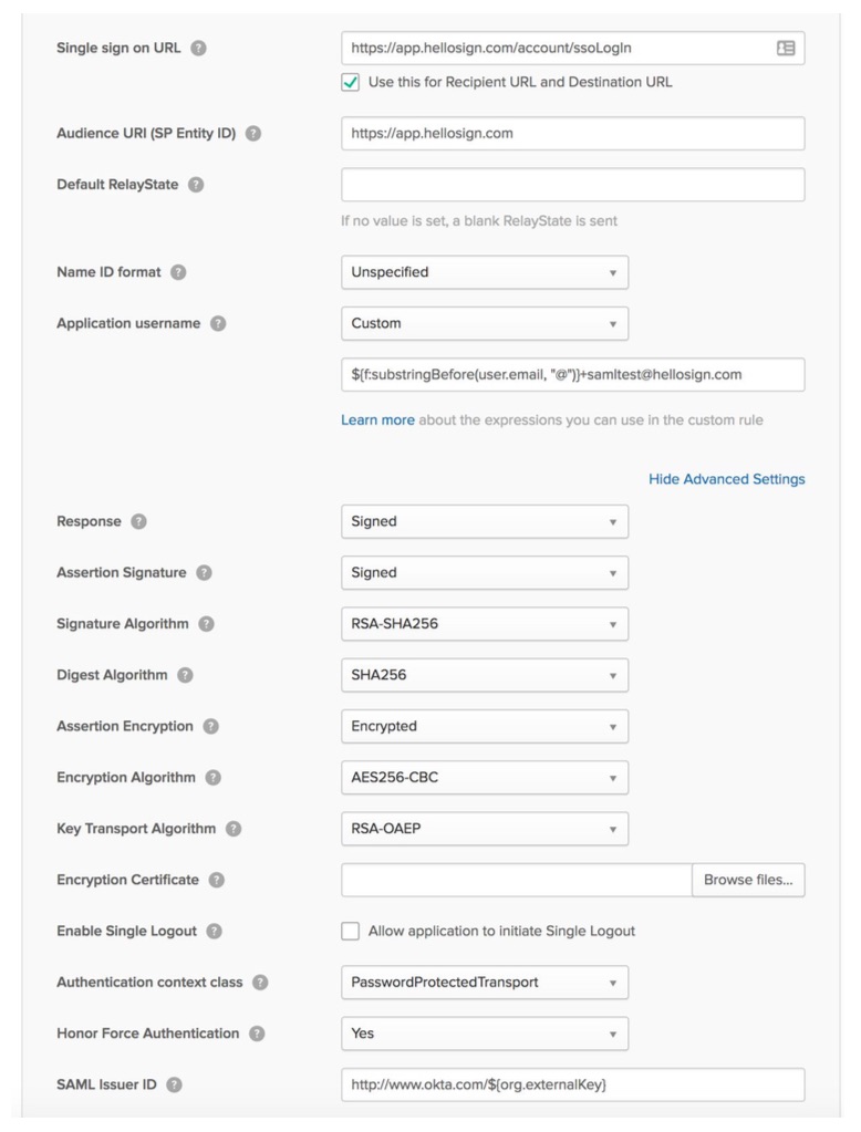

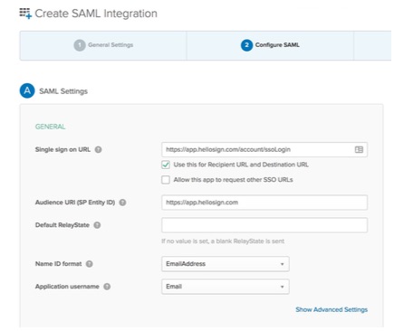

  1. Your IdP will require the following information exactly as shown:
SAML settings

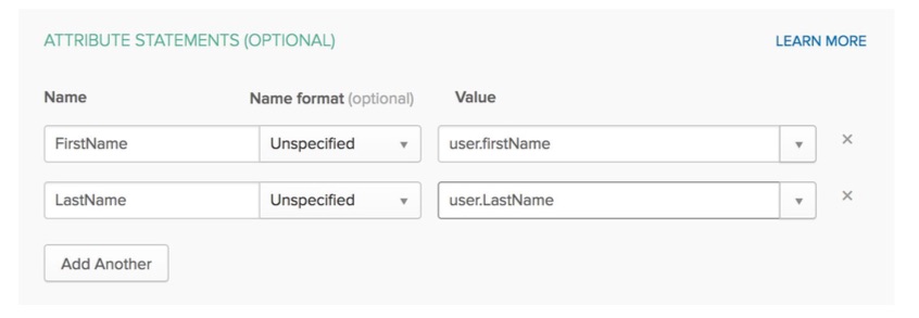

Attribute statements

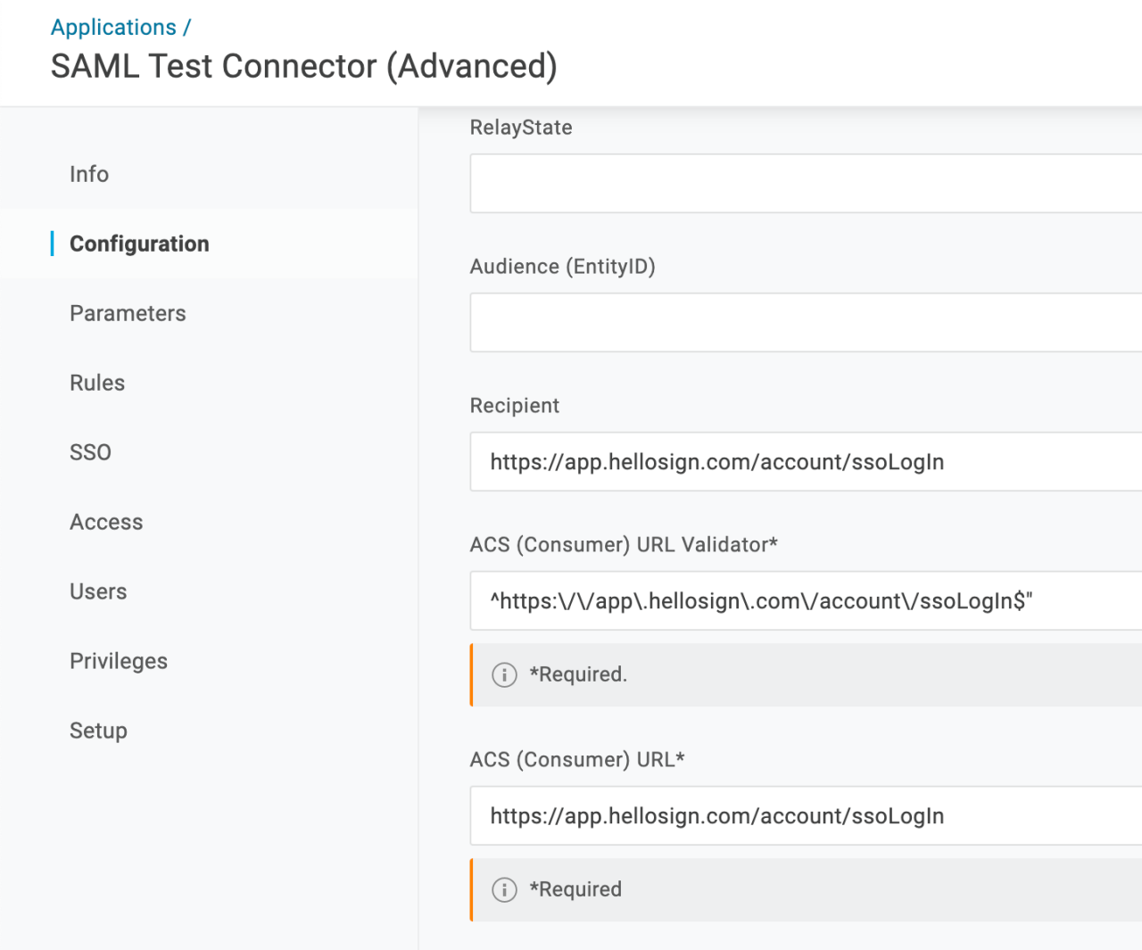

OneLogin
If OneLogin is your organization's SAML SSO provider, ensure the following information is filled out:
SAML test connector

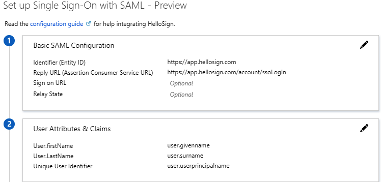

Microsoft Entra ID
If Microsoft EntraID is your organization's SAML SSO provider, ensure the following information is filled out:
Dropbox Sign Settings
  • Identity Provider Single Sign-On URL: https://login.microsoftonline.com/xxxxxxx-xxxx-xxxx-xxxx-xxxxxx/saml2
    • Referred to as "Login URL" in Entra ID
  • Identity Provider Issuer:
    • Referred to as “Entra ID Identifier" in Entra ID
  • X.509 Certificate: Use "Certificate (Base64)"
    • WITHOUT "-----BEGIN CERTIFICATE-----" and "-----END CERTIFICATE-----" as single line string (no line breaks)
Entra ID Settings
Single sign-on with SAML
